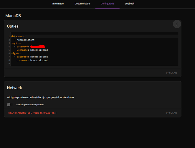

config → addons → mariadb → configuration
looks like this:
That is where I put the data. I was just looking for where the actual file was like configuration.yaml,
I guess that it is just stored in the database.
