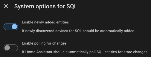

[MONITORING]
As an example, you can add these SQL queries in configuration.yaml (no plugin is needed, it comes integrated in HA):

The above solution will (by default) run all of the queries every 30 seconds.
My HA CPU went up from 2-4% to 12-20%.
That's why I moved from the sql: config in configuration.yaml to the SQL integration UI.
Why? Because you can "DISABLE polling for changes"
Result? Now I have 100% control over which queries run when.
