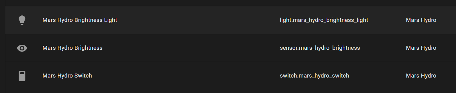

i completely reverse engenieered the whole api of the androdi app by man in the middle attacking my own network with an decryption certificate.
After that printed out the api calls, wrote a python script to implement and test functionalities.
  • logging in via username and password
  • get device ids
  • get state of device (turned on / off / brightness value)
  • turn on and off lamp
  • set brightness of lamp
last days i started creating my own integration and managed to do so, i can now control the lamp which is connected to the mars hydro cloud via app.
some screenshots (can only post one since im a newly registered here)
everything works fine for me, but seems integrating officially into hass needs some verification like bronze status or silver aswell as some security features and so on.
this is alpha alpha version, goal for me is to control the brightness in relation to the watt generated by my solar system.
so in case my solar system gets 300w ++ i can set my lamp to 100% since its an FC 3000 with 300w.
ill keep you guys updated, this was round about 3days work of 6 hours daily
cant post more than 1 screenshot in one post (cause newbi) so i do post by post.
controlling the lamp now works fine in my dashboard. i can turn it on and off aswell as setting the brightness.
also automation for controlling my usecase works fine.
with that you will be able to set the light schedule for turning the light on and off via automations aswell.
