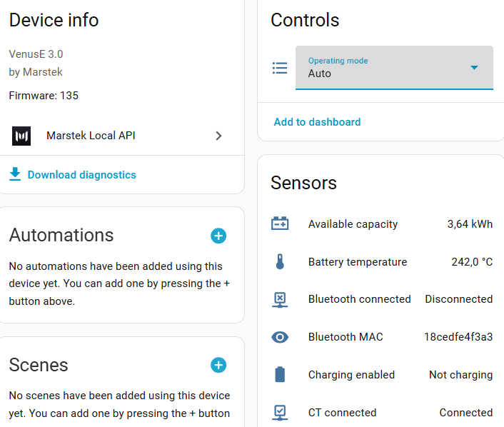

Hello. I have received my battery on friday and I just installed your integration.
Everything is OK but the temperature seems a little bit hot :sweat_smile:
