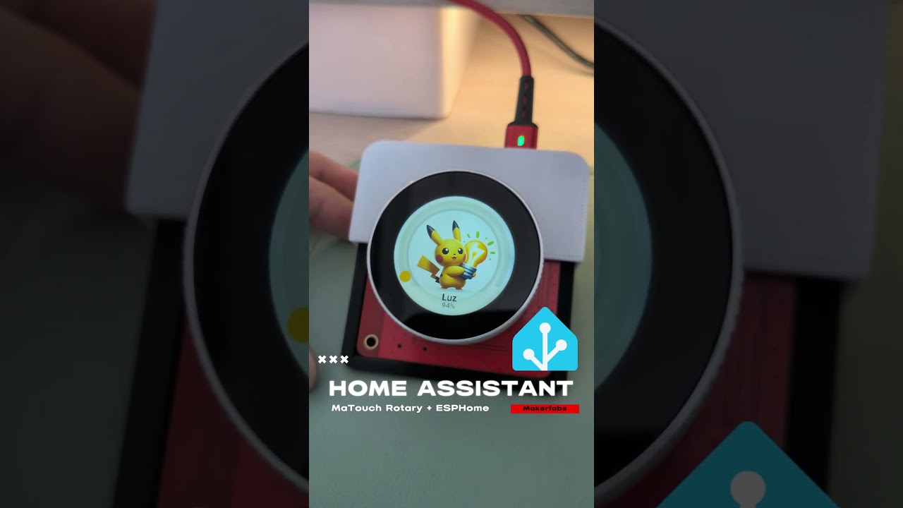

Here is my example using ESPHome and LVGL!
