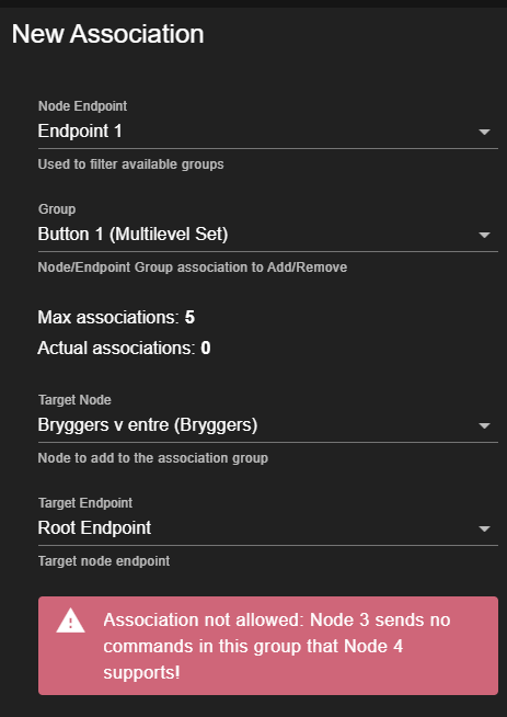

I have a bunch of LogicGroup Matrix ZDB5100 switches and I want to create associations between them in rooms where I have two switches controlling the same light.
I’m not entirely sure how the association should be setup, but I think I need an association from switch one Endpoint 1 Button 1 (Multilevel set) to switch 2 “Root endpoint”, but when I select group button 1 multilevel set for switch 1 and i select switch 2 as target node, I get an error in the UI “Association not allowed: Node 3 sends no commands in this group that Node 4 supports!”.
If I choose “binary switch set” in stead it just toggles the led in the switch button itself and not the dimmer.
Am I missing something, or is it a bug?
