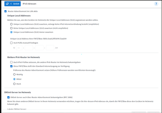

  • checked if ipv6 is enabled on my network itself. I have a Fritzbox 6591 as a router and behind that 2 TP-Link EAPs (245 + 653) behind that as wireless access points. No Vlan, no fancy stuff. IPv6 is enabled on my fritzbox
