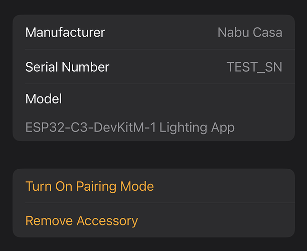

  • Under the accessory details all the way at the bottom there’s a “Turn on Pairing Mode” button. After a second a modal pops up with a new pairing code.
  • In the Home Assistant Matter integration I pasted that code into “Commission Device”. python-matter-server chugged along for a bit, and then I reloaded the integration and it was added!
