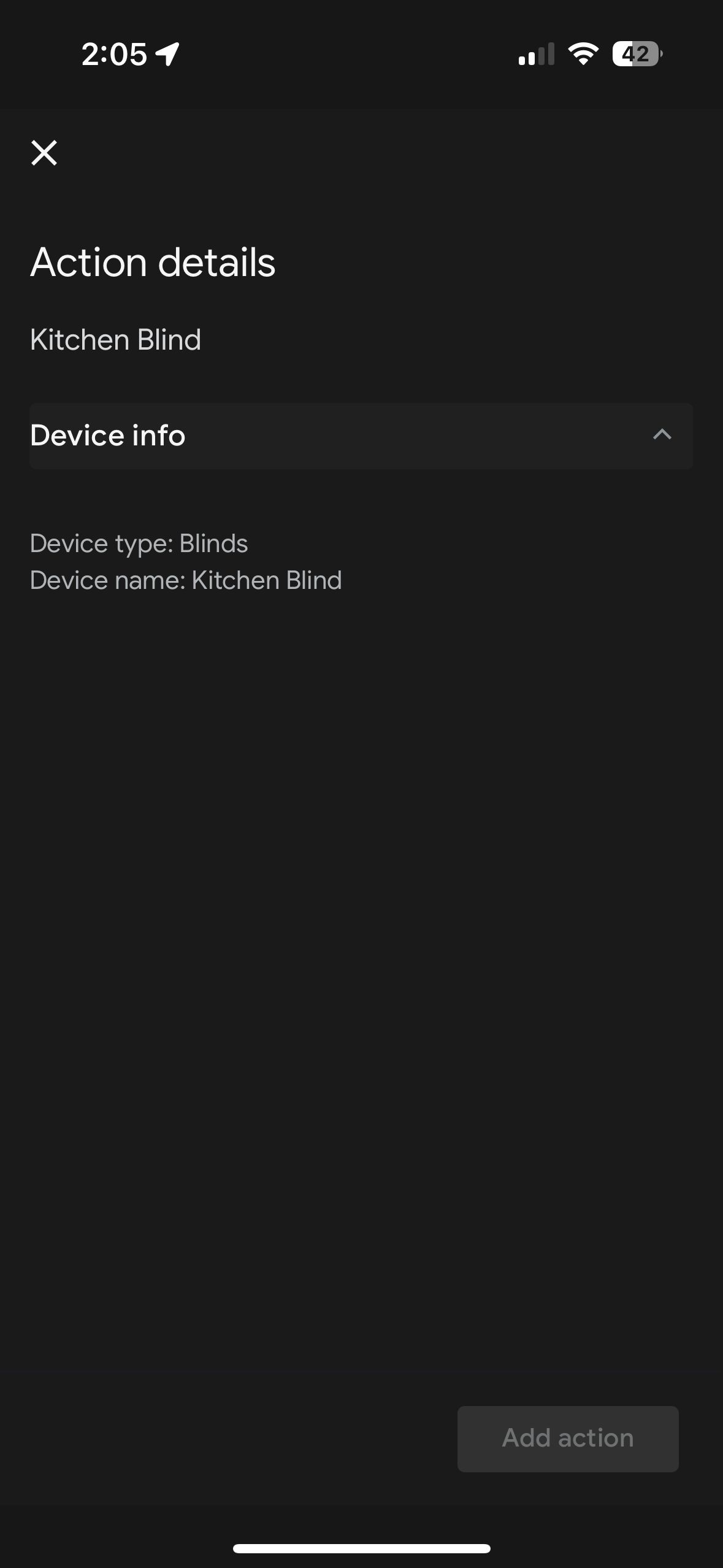

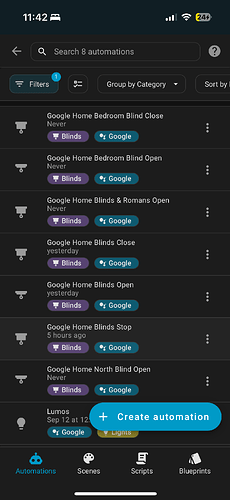

I don’t have a option to control my zemismart zigbee blinds via automations (nothing comes up as an action) but a workaround was creating an automation in HA and exposing it to the add on, then controlling the automation via google home automations.

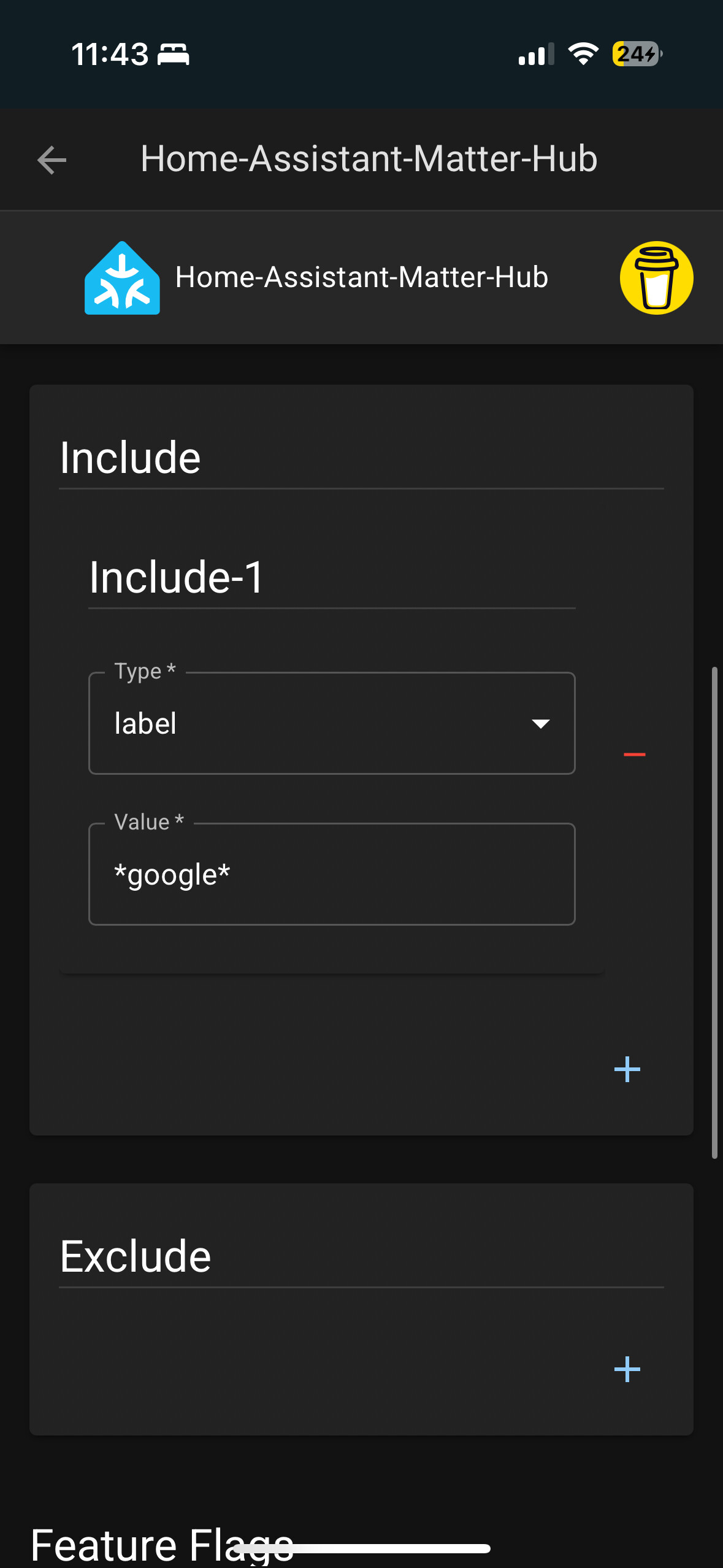

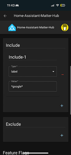

where do you paste this yaml? I’m guessing its not configuration, because it looks like part is missing?
sorry, I’m new!
edit: do I paste it inside the configuration of the add on?

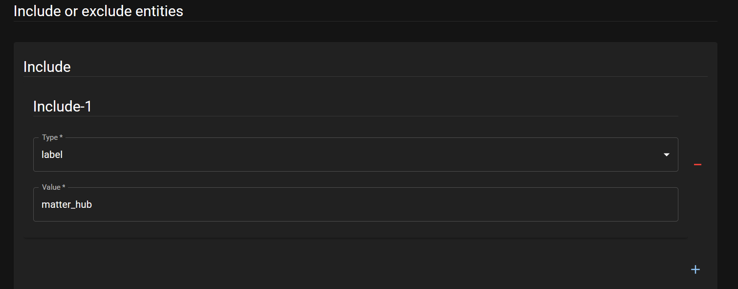

Just set it up using the GUI of the add on:
I used the label ‘matter_hub’ but you can use whatever you like.
What is posted above is the underlying json which you can view from the GUI.
dohh… thank you! still getting used to the terms. I had made a list of about 30 words I wanted to include and exclude which was getting complicated, so I created a label but couldn’t work out how to implement it. thanks :slight_smile:
I deleted all my other filters and looks like I broke it :sweat_smile:
nothing is coming up as a device now. any idea how to fix? I tried it with both google and google and re-started the add on
