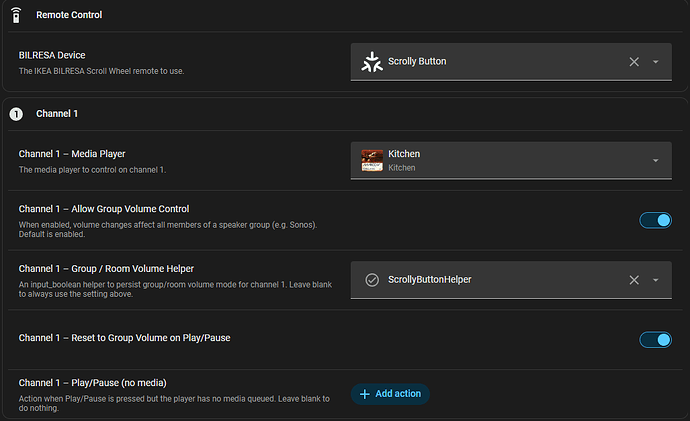

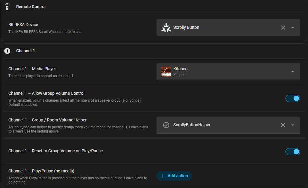

Basic Configuration
Select your Bilresa Scrollwheel device, then you have three channels which can be applied to different media players, each with their own configuration. All of options below apply per channel.
Media Player
Choose a channel media player to control (or a media player that will act as the main device in a scenario where other players are grouped with it).
Dynamic Volume Control (Group vs. Room)
You can choose to disable group volume control by using the Allow Group Volume Control option, it is enabled by default. If you want to use the option to dynamically switch between controlling the group volume and just
the room volume, you must select an Input Helper (Boolean) to store the state. If you have multiple Bilresa Scrollwheel devices and use this Blueprint with multipe automations you will need an input helper per channel per device.
By default volume control will revert to group when Play/Pause is pressed, if you want to prevent this behaviour, turn off the Reset to Group Volume Control when Play/Pause pressed setting.
Hold and Release the scroll wheel button to switch between Group and room control.

Play/Pause Action
You can configure an action to run when the Play/Pause button is pressed but no media is playing and the playlist is empty.
Example Showing Channel 1 Configuration
