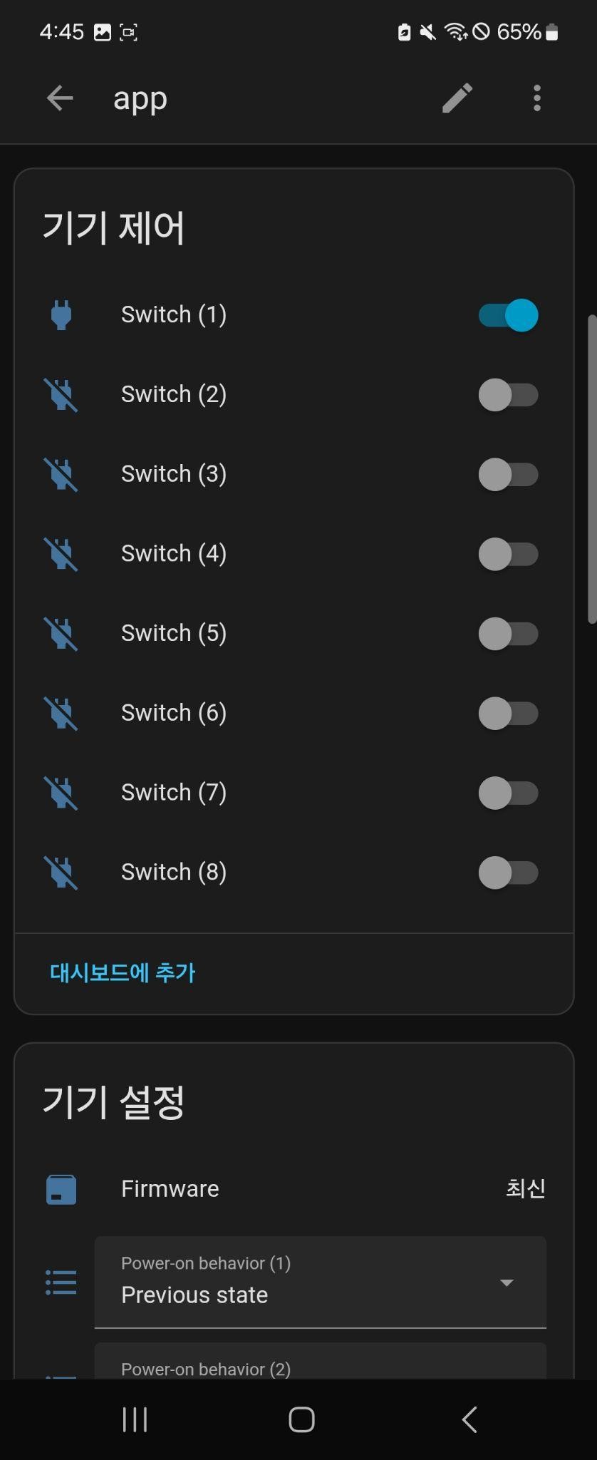

We are developing a Matter-certified device using the On/Off Plug-in Unit (0x010A). The device functions correctly; however, we have encountered an issue that is hindering our product launch.
Across the ecosystem, including Home Assistant, this unit type is consistently displayed as a generic “Switch” UI, regardless of the userLabel or ProductName settings.
This leads to the following two concerns:
  1. Branding – The “Switch” label and toggle icon do not accurately represent the product’s actual purpose and do not align with its intended identity.
  2. Safety – Users may interpret the device as a standard switch and operate it in inappropriate situations, which could potentially lead to safety risks.

Can you provide a screen shot when using Home Assistant to describe what is being displayed that is causing the concern?
Next, maybe provide a mock up of a similar screen shot of what you would like for it to look like.
Might be helpful to describe the intended application and safety limits of concern.

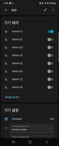

The attached images show how our device is currently displayed across different platforms. This is not a Home Assistant-specific issue — the same result appears across all platforms.
The closest example of what we are looking for is actually a screenshot captured from Home Assistant in July last year, when HA was displaying the UserLabel value directly in the UI. That is the behavior we would like to see.

For comparison, here is how the same device appears across other platforms today.
[current platform screenshots]
