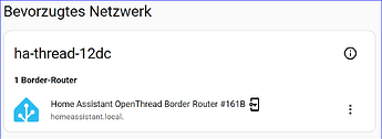

I’ve installed the ZBT-02. It’s running
OTBR is running.
Thread is running
Matter server
2026-02-04 10:16:39.824 (MainThread) INFO [matter_server.server.server] Matter Server successfully initialized.

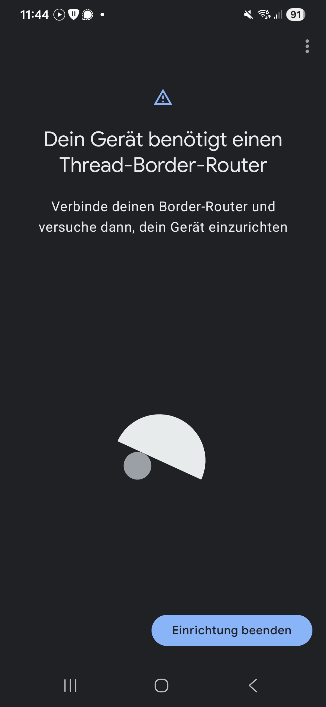

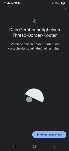

If i try to connect a Ikea MYGGSpray with the app:
If the key is showing, make sure you’ve imported the Thread network credentials to your mobile phone. Companion App: Settings | Troubleshooting | Sync Thread Credentials.
thx
the Problem is, that i used my phone with another instance of HA. If i liketo reset the setting i have to delete half of my settings in the androit phone. But in the end it work with a other one.
thx for ur help.
