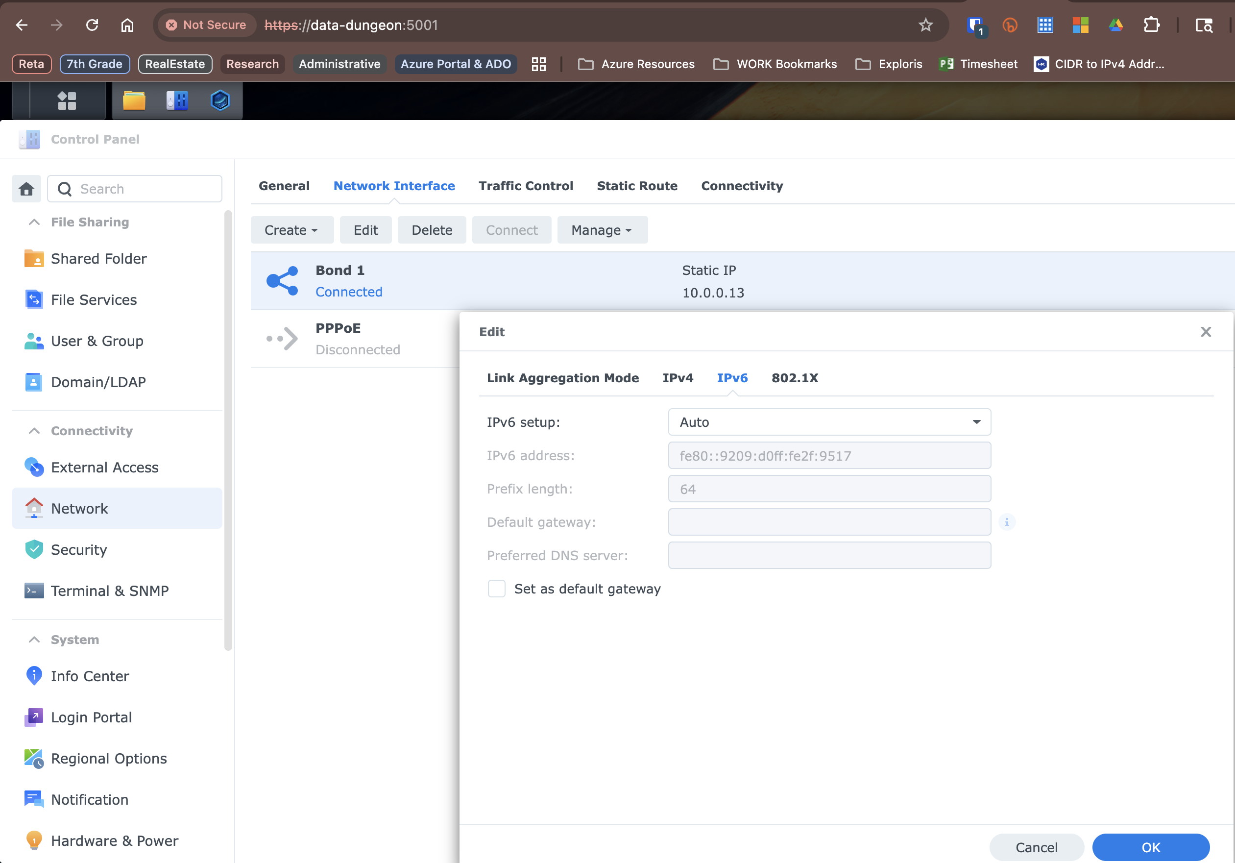

Within DSM I activated IPv6 support in the network options:
System Settings/Network/Network Interface → Edit you used network connection → IPv6 Tab → IPv6 Setup: Automatic

  • Added IPv6 support (auto) to my eth0 bond in the GUI of DiskStation

    Once the IPv6 piece was added, I used Google Home App
Can you explain what do you mean by adding IPv6 piece?
See image:
