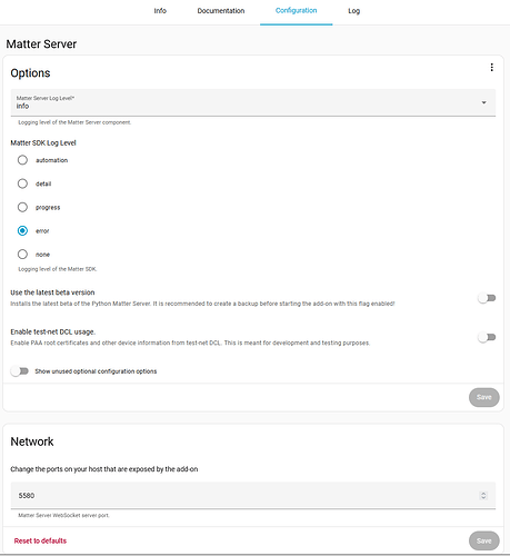

  3. I opened port 5580, and I was able to navigate to :5580 and it worked, but this is only a solution when I’m at home and does not work remotely. But it works, so this tells me that something is wrong in the Home Assistant configuration.

I opened the port again this morning and restarted the Matter Server, and yes, I can access the web UI locally using the direct link through the open port. But it does not – obviously – allow me to access the web UI through ingress or using Nabu Casa.

Unfortunately no. I opened a bug and it was marked as closed and not planned. Kind of frustrating. It seems to come back periodically, but I haven’t had access in about a month at least now. My workaround is to set an open port for the Matter Server in the configuration page, and then access it directly via the IP address. That only works locally, so when I’m away, I have to VPN to reach that page. It’s annoying and I see others with the problem. Wish someone on the dev team would look into it. It HAS to be a bug. It’s not location or device specific, so not a firewall or anything like that. Sorry I couldn’t offer more.
