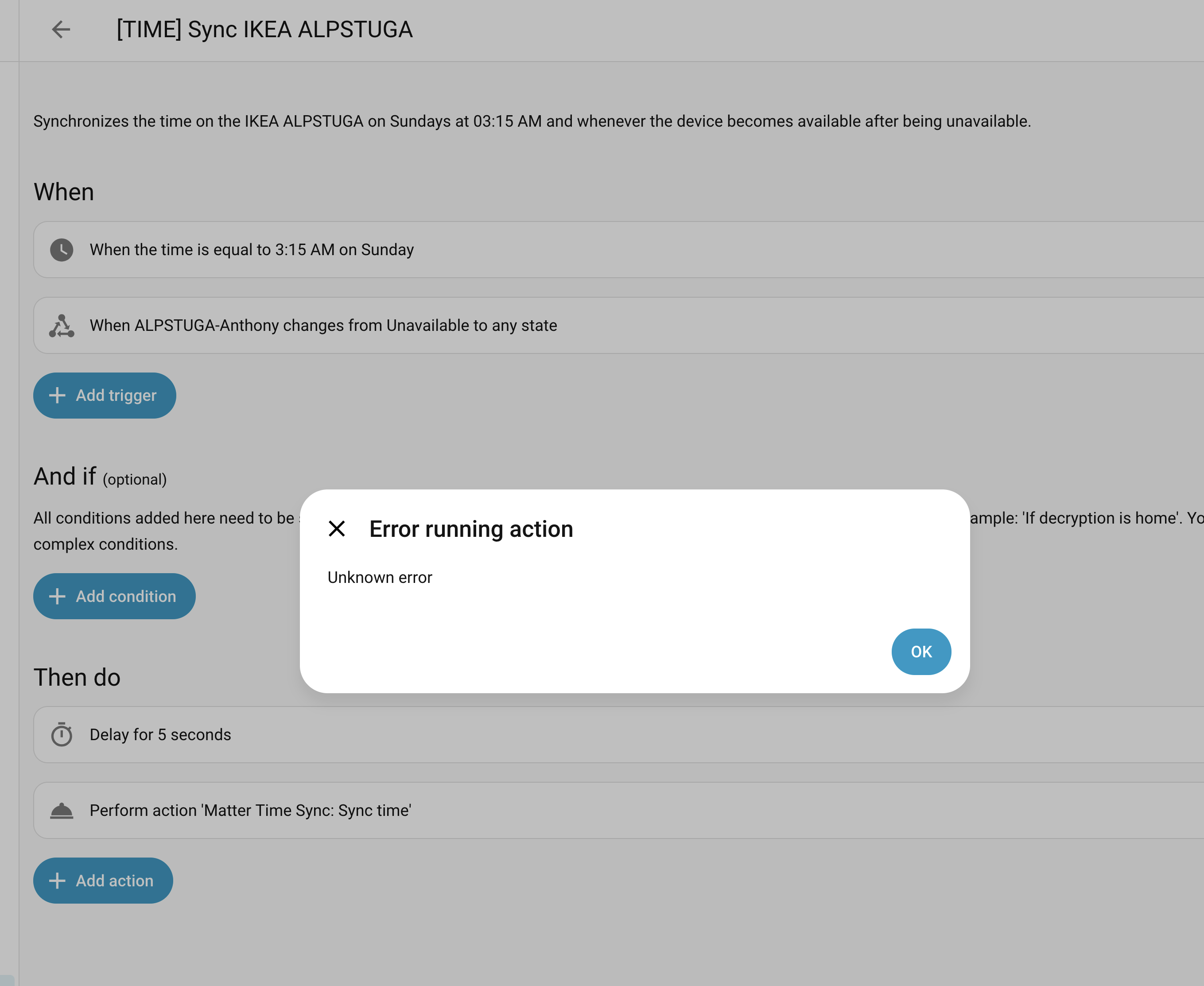

I gave this add-on a shot as it sounds really handy, but whenever I try to use it in an automation, I get this error:
And this pops up in the debug logs:
2026-01-16 23:03:41.577 INFO (MainThread) [custom_components.matter_time_sync] Starting sync for node 3 (ep 0)
2026-01-16 23:03:41.588 DEBUG (MainThread) [custom_components.matter_time_sync] Server Welcome: {'fabric_id': 2, 'compressed_fabric_id': 7760850010980266393, 'schema_version': 11, 'min_supported_schema_version': 9, 'sdk_version': '2025.7.0', 'wifi_credentials_set': False, 'thread_credentials_set': False, 'bluetooth_enabled': False}
2026-01-16 23:03:42.194 ERROR (MainThread) [custom_components.matter_time_sync] FAILED: Time sync error: Matter Server Error: {'message_id': '2', 'error_code': 0, 'details': 'InteractionModelError: ConstraintError (0x87)'}
2026-01-16 23:03:42.196 ERROR (MainThread) [homeassistant.helpers.script.websocket_api_script] websocket_api script: Error executing script. Unexpected error for call_service at pos 1: Matter Server Error: {'message_id': '2', 'error_code': 0, 'details': 'InteractionModelError: ConstraintError (0x87)'}

Tracing the automation shows that it cannot connect to the HA server:
Perform action 'Matter Time Sync: Sync time'
Executed: 26 January 2026 at 13:43:55
Error: Cannot connect to host 10.0.0.10:5580 ssl:default [Connect call failed ('10.0.0.10', 5580)]
Result:
params:
  domain: matter_time_sync
  service: sync_time
  service_data:
    node_id: 11
    endpoint: 0
  target: {}
running_script: false
What’s missing in the directions is that you have to expose the TCP port 5580. To do this, go to Settings → Add-ons → Matter Server → Configuration → Network and add 5580 to expose the Matter Server WebSocket port.
After doing that, it worked perfectly for me.
Credit to BMOtheConsole on github for that fix.
