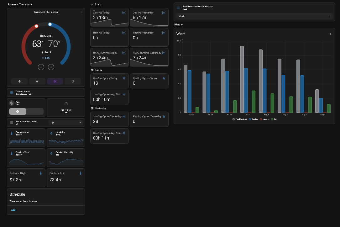

Just got my Meross MTS300 installed last week and worked on getting it configured in the system.. digging this local control and better stats than my nest ever had!
What integration did you use? Are you willing to share how you made that dashboard if it’s not just entities in the thermostat?
Just using the matter integration the meross mts300 is thread over wifi so it shows up as a regular thermostat. All the cards and data are just helper history stat cards i used to collect the data from the thermostat for when a state is active. So far its been rock solid. I think im going to replace the rest of my nest thermostats with these.
