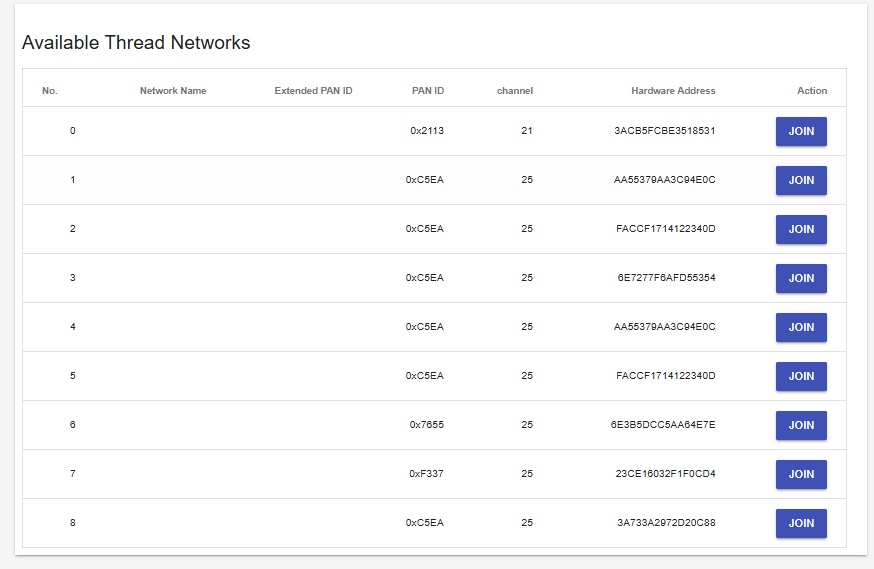

The other thing i'll mention is that the other PAN ID's when scanning using the OTBR Join section within the UI is neighbor Thread Networks - my devices are on 0xC5EA.
