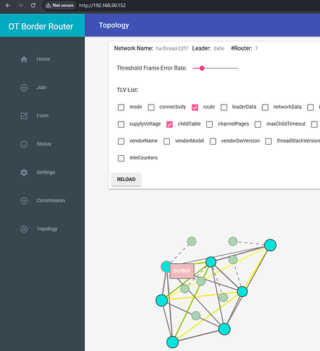

When I go to /config/thread in the Home Assistant web UI, I see this.
When I access the matter-server webpage at http://localhost:5580, I see this. All my matter+thread devices say “OFFLINE”. However, my matter+wifi devices are fully operational.

Another thing I noticed is that my otbr interface is down…
$ ip addr show wpan0
37: wpan0: <POINTOPOINT,MULTICAST,NOARP> mtu 1280 qdisc noop state DOWN group default qlen 500
    link/none
Hmm… maybe the Thread side of things is causing the issue here…

Hmm… I wonder what the difference is between openthread/otbr and openthread/border-router. I’m using openthread/border-router because I found it here: Docker Install  |  OpenThread
I noticed the openthread/otbr is like 10 times larger. It also has otbr-web, which border-router does not have.
Unfortunately, when I switched to openthread/otbr@sha256:4db55b28820ee3bdba3b4a6af33f86867a17fc479530b65743bf7c777bbf274c, I got the following error.

I do not remember where I got this image from. Speaking of web - yes it has a frontend
That is the interface on the web port on the OTBR.
If you are running the OTBR as an addon in HA, then the ports are disabled by default and you need to set both to active in the configuration and then restart the addon.
