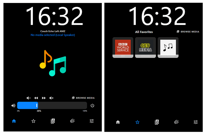

So I can see my media in the native Media section on the sidebar - I’m using NAS so it lost the connection. But I still don’t see it in Maxi Music Player.
Here’s are photos of what I have now. First, I click on the Star, then I can click on CESmedia or the White box with music notes in it, but it say no media.
Here is the card yaml:

It’s under ā€œbrowse mediaā€

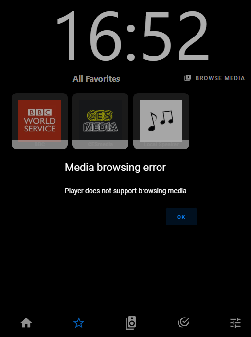

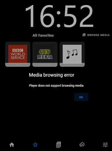

I updated my yaml. I copied an older card. And when I tap on browse media, I get the following error:
**Edit: When I tap on BBC World Service, I get an spoken error from Alexa: ā€œTo send TTS, please set announce equals true. Music can’t be played this way.ā€
Please create an issue on GitHub so we can dig into this
