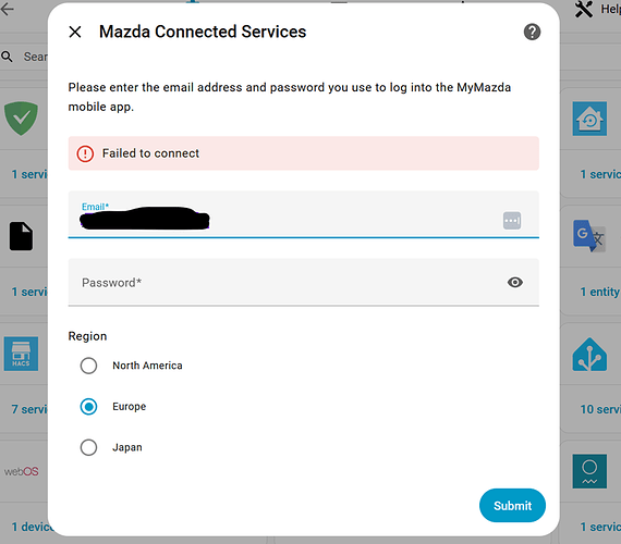

February 13, 2026, 11:49am
17
Hi, I’m trying to install the integration but I’m unable to finish the setup. I’m always getting a “Failed to connect” message. Any help? Thanks!

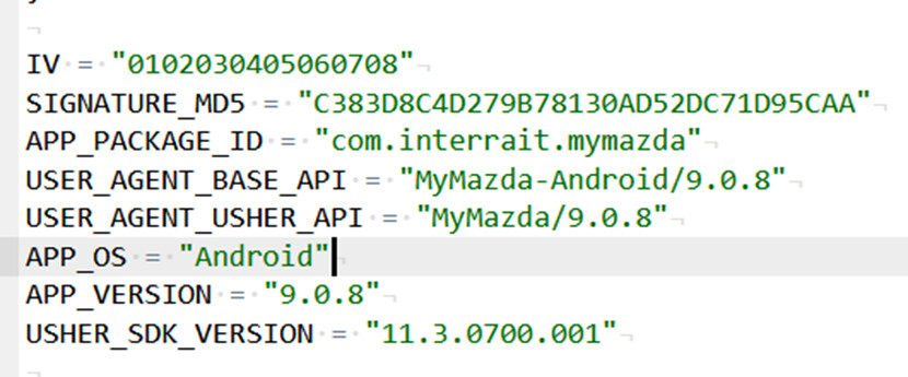

February 13, 2026, 1:40pm
18
I can confirm that updating the user agent to match the current app version still fixes the connection issues. Replace with 9.0.8 in 3 places.
odub303
(Odub303)
February 13, 2026, 4:55pm
20
I see you’re in Europe. Is the app version number different for you? I’m in North America. All I needed to do to connect was update the app version to the current version number in the connection.py file.
