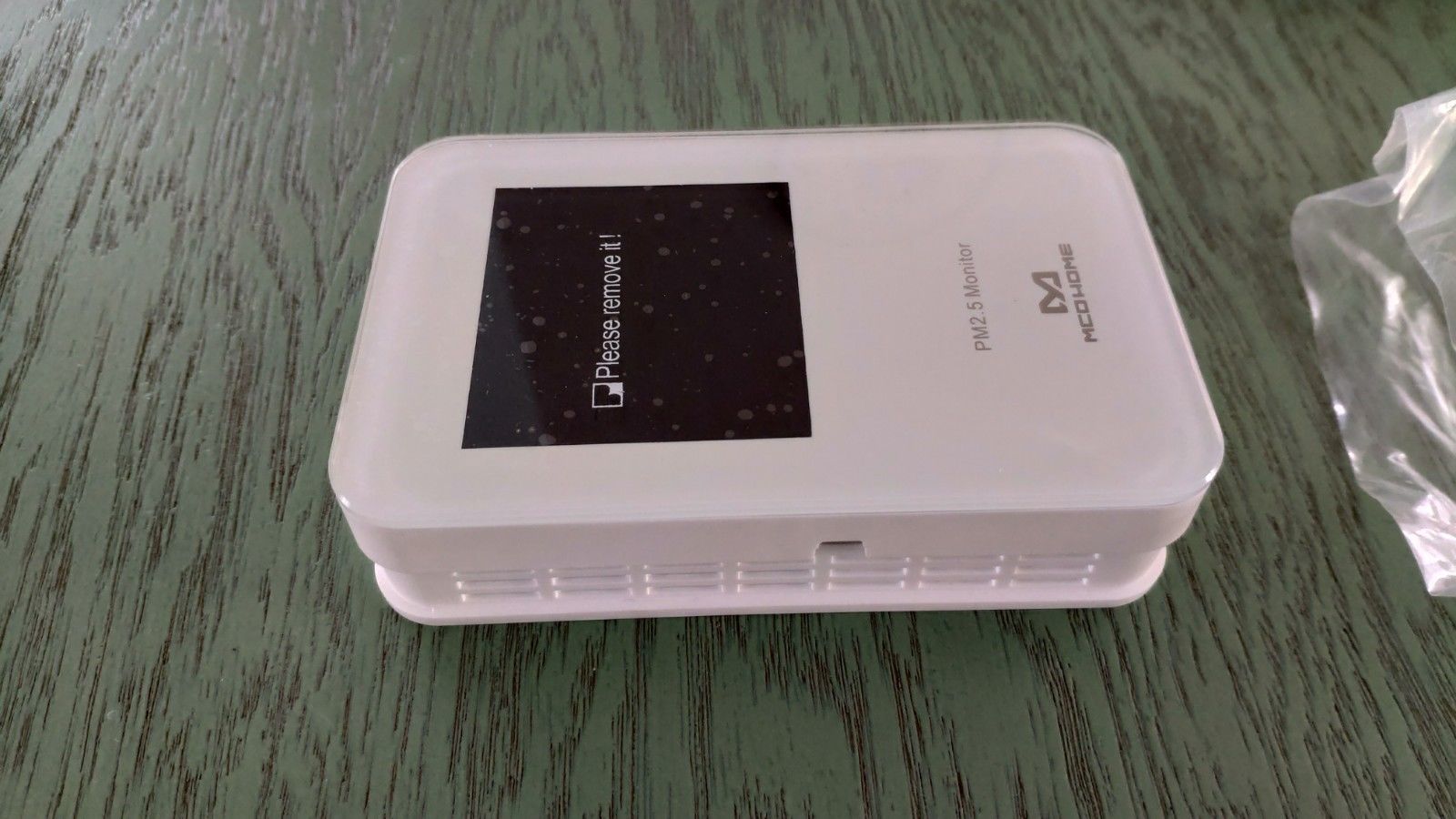

I bought the MCOHOME PM2.5 Monitor MH10 -
https://www.vesternet.com/mwdownloads/download/link/id/1542/
The device displays data PM2.5 only on its own screen. But does not send PM2.5 data to the controller via z-wave. The device transmits data to my hub only temperature and humidity. But doesn’t transmit measurement data PM 2.5 to z-wave hub. There was no problem with connecting to the network, but in the field “Entities of this Node” shows only Temperature and Humidity entities. Home assistant did not determine the measurement pm2.5 function of this device. Home assistant supports this device? Why does it determine temperature and humidity, but does not see PM2.5 data?
