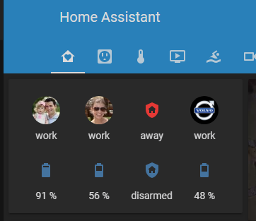

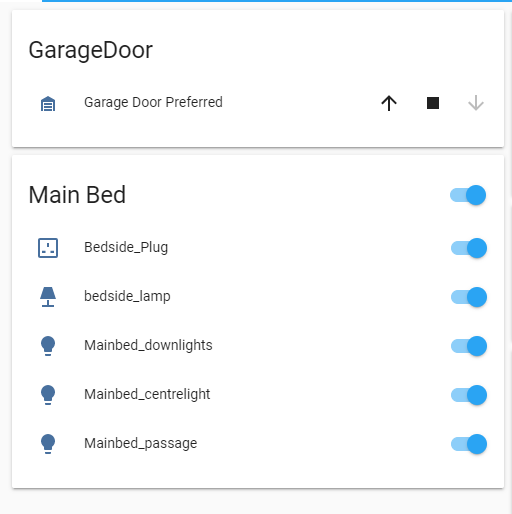

I just updated my Hass to the latest release and also updated the Operating system to the latest (3.11), after the update, my icons are no longer turning yellow when on, they stay gray as below:
My device tracker icons have also formed into a group within the body of the UI instead of being on top:
What can I adjust to return to the previous setup.

You need to add the state_color option to the card starting at version 0.105
See section “Icons no longer change color based on state” from these release notes:
tom_l
February 20, 2020, 4:46pm
3
And what a PITA it is.It should be on by default.
i am migrating stuff I want to lights.yaml, I can confirm that when it is in lights and changed from a switch to a light, it works
Any idea how i can move my devise trackers up from this setup:
to this setup:
It changed with the update…

Though, fwiw, I do something similar in lovelace using a quick glance card w/ show_name: false currently:
- type: glance
show_name: false
columns: 4
entities:
- entity: sensor.google_maps_mark
picture: '/local/Mark.jpg'
- entity: sensor.google_maps_amber
picture: '/local/Amber.jpg'
- entity: sensor.alarm_dot_com_sensor_home
tap_action:
action: call-service
service: script.turn_on
service_data:
entity_id: script.set_home_alarm_click_ui
- entity: sensor.google_maps_volvo
## Row 2
- entity: sensor.battery_mark_pixel
- entity: sensor.battery_amber_pixelxl
- entity: sensor.alarm_dot_com_sensor_work
tap_action:
service: alarm_control_panel.alarm_arm_away
service_data:
entity_id: alarm_control_panel.work
- entity: sensor.battery_ipad
thanks, I will just have to change to lovelace as the UI is depracated
how do i remove the name on top as highlighted below:
