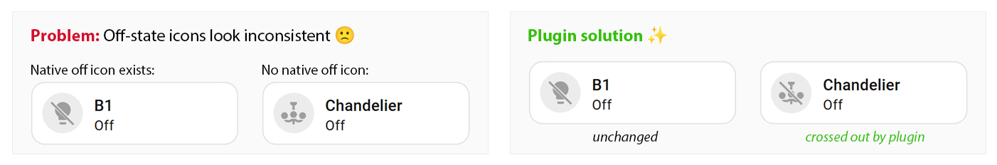

🚫 MDI Off Fallback for Home Assistant
Home Assistant lets you use any MDI icon, but not every icon has an -off variant. As a result, a device may already be off while its icon still looks active. This plugin automatically adds an MDI-style slash to inactive entities when no native off icon is available.
The plugin is designed so that the added slash looks like a native part of Home Assistant:
  • works with standard Tile cards without replacing them, preserving their native appearance, behavior, colors, sizes, and interactions;
  • also supports :mushroom: Mushroom Template Card; the card must have an entity configured so the plugin can determine its state;
  • modifies only icons that have already been rendered and only when no native -off variant is available;
  • does not change entity states or interfere with device operation.

Thank you for your point. And yeah, as Nezmo said, you can easily cancel this behavior via configuration.
I added this because not all icons are centered and stroke without background circle on some of them looks strange for my internal esthete:
demo-to-user-of-forum
BTW, I created this tiny plugin as a part of bigger one and then understood that I need to separate responsibility. So, It will be good for some nerds, but of course I understand that it does not solves serious problems :slight_smile:
