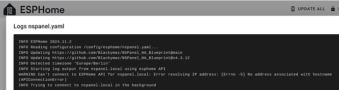

I am running Homeassistant since a while on a Raspberry and most runs more than good but… I have 3xBluetooth proxies and 1xNSpanel Pro managed through ESPHome and one Proxy as well as the NSPanel is going offline sometimes!?
I have a straight forward network configuration, all on a single network 192.168.0.0/24, managed from a German FritzBox 5530.
I can resolve homeassistant.local as well just fine. Also 2 Bluetooth proxies are shown online in the routers network configuration 100% of the time. However 1 proxy isn’t…
I can upgrade the offline devices after rebooting those and immediately clicking the ESPHome Upgrade button in Homeassistant but that’s just annoying.
I am wondering what about mDNS and my configuration causing this trouble!?
I am not a networking specialist but would like to understand what I can do here to get the Bluetooth Proxy and NSPanel online 100% of the time!?
My domain, by default on all AVM FritzBox routers, is usually fritz.local btw. it seems that mDNS is on .local!?
Here are some Screenshots of ESPHome and DNS troubles:

Had the same problem. Just add the domain you use to your wifi config.
wifi:
  domain: .fritz.local #(or .fritz.box or whatever)
