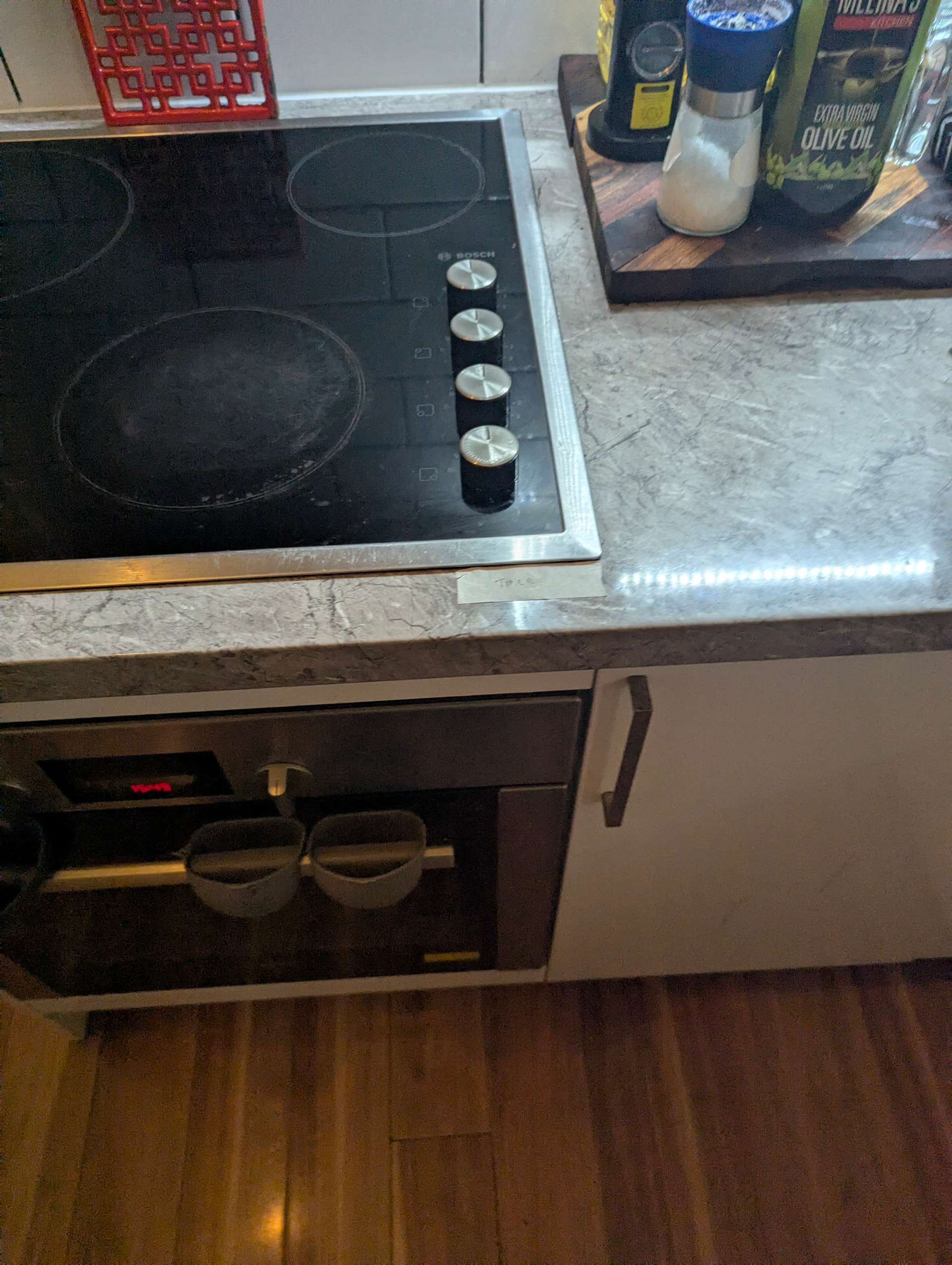

Setup:
- NFC tags via AliExpress. Be aware many won't work on metal surfaces unless specifically design to.
- Mealie install, with trustworthy meal prep time data in recipes
- Mealie integration, with working call to get_mealplan
- A timer entity.
I'm experimenting with placement still, so using tape as a quick label/way to relocate it. When permanent home identified, will likely glue it down.
