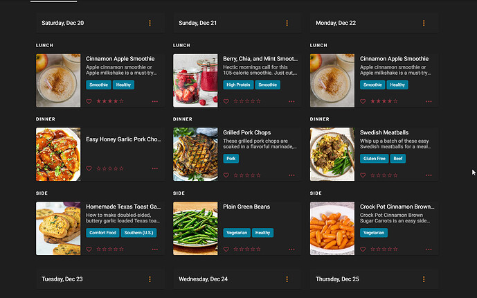

Hi All - Thought i would share this cool automation I made, This creates a meal plan in mealie for the next 7 days on Sunday morning. When I get undesirable results I usually just adjust the randomized menu from there, overall it’s less work than manually creating a meal plan every week. I use this also to create grocery lists to go back into home assistant when I go to the grocery store.
Enjoy

Produces a fully filled out meal plan from your recipies
