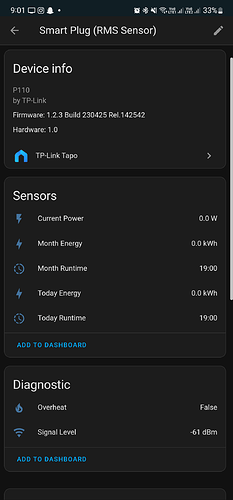

Ill order one and try it out, I grabbed a TP Link plug with energy monitoring too, so I can compare them.
