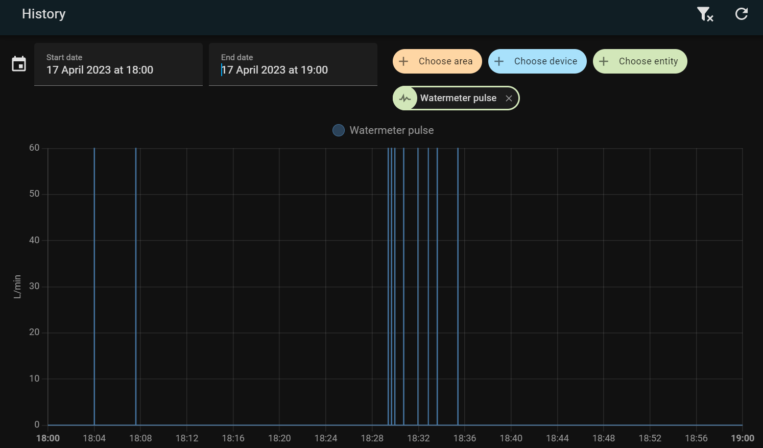

I’ve made the water meter for my house smart using one of these devices - Waterlezer dongle – smartstuff
I can now track amount of water and I am using and the rate, however given that it reports the pulse rate of water, I’m struggling to think of a way to automate based off it.
To clarify, I am trying to create an automation if the water flow rate is above 50L/min, along with a bunch of other condition, and then increase the volume on the bathroom speakers. Idea is that if the shower is running then increase the music volume.
I want to trigger the automation if the flow rate is above 50L/min for 25 seconds (approx refill time of toilet so I don’t want to trigger this from a flush) but because it’s a pulse rate, the value isn’t sustained for very long.
Any suggestions on how to capture this trigger?
