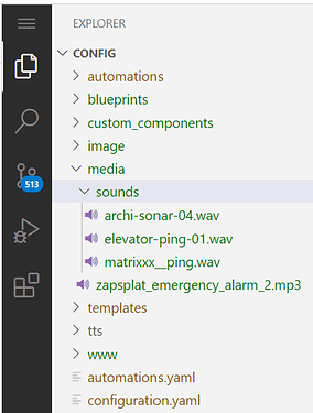

I am still going nuts with this issue. I have just changed the config - I hope - to what you have suggested above:
  • configuration.yaml
homeassistant:
  customize: !include customize.yaml
  media_dirs:
    local: /config/media
I tried to change configuration.yaml folder back to
media_dirs:
    media: /config/media
I still cannot browse the media. Correction: I just realized that the Media Browser is specific to a media player. I can conform that I can see the media in the Media Browser for the Google Mini’s but not for the Sonos players.
However, when I go to the media players, I can select and play the sounds on my Google/Nest Mini’s
However, if I try to select media from one of the Sonos media players I get an error.
I am at my wits end!!! Any and all help will be greatly, greatly appreciated.
Did you ever find a solution to this? I’m at the same point. I can get a file to cast to Google Home after creating the folder and declaring it in config.yaml as suggested by @DevOpsTodd , but can’t get it working for Sonos. So infuriating! TTS to Sonos works, so there must be a way to send a local file.
