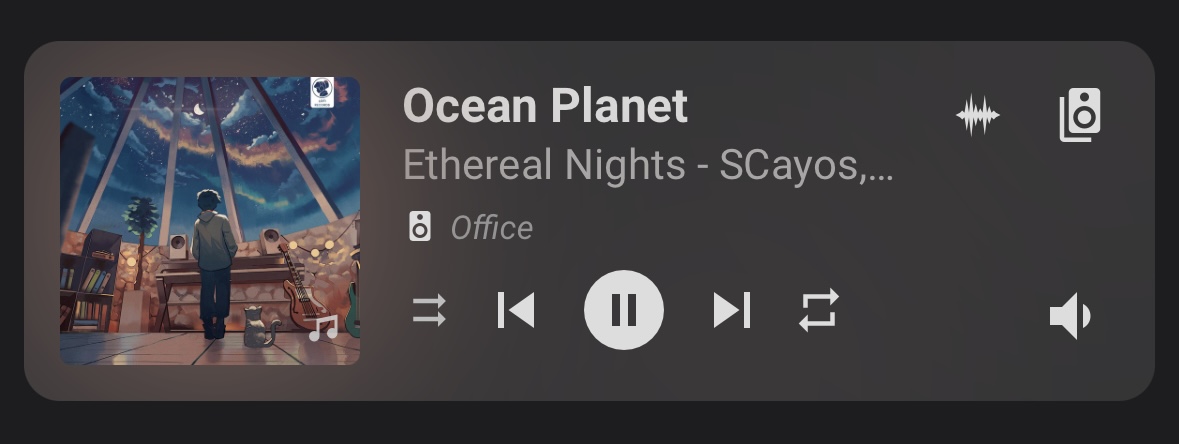

I have been developing a set of custom media player cards for myself, and my wife, to easily control playback, grouping and provide shortcuts.
I want to gauge if there’s any interest in making this a proper project (with less shortcuts and more stability).
It consists of two cards. A ‘regular’ media player card, and a card made for panel mode (full screen player).
Regular card:
Panel Card:
You can find more info on github here:
Would love any feedback, and feel free to take it for a spin.

Top screenshot is mode: in-card used with pop-up card from browser mod.
Bottom is mode: card
