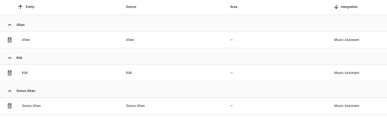

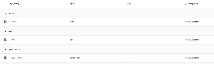

Yes, I have seen these instructions, but I am not sure what entity to use??
I do not have any entity starting with ‘music_assistant’ or ‘media_assistant’. The entities I have is only the speakers in each room, created by MA.
Ahh! I have an error there. It’s all just media_player entities.
So you would would fill out both entity_id and ma_entity_id with the same media_player entity id.
There’s no such thing as a media_assistant entity. I just didn’t proofread the docs thoroughly enough (ai generated most of that doc).
