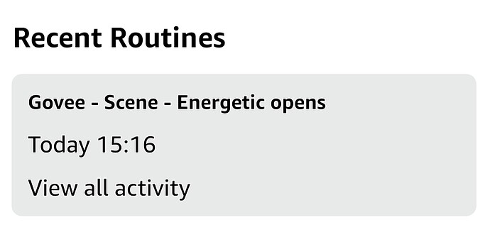

The Custom command function, which emulates voice commands, will not trigger Alexa routines. To trigger routines you have to use routine as the media_content_type and the exact name of the routine as the media_content_id.
service: media_player.play_media
  entity_id: media_player.front_bedroom_echo
  media_content_type: routine
  media_content_id: |
    Govee - Scene - Energetic opens
Ok. Even the github repository describes sending voice commands to trigger routines using custom.
So i thought that would work.
However, if i need to use routine as the method, i am unsure as to what would be the WHEN action in the routine. I am assuming that this will be ignored if the play_media call is used?
Correct, the trigger inside Alexa is bypassed when you call the routine from HA. You can leave the voice trigger phrase as-is if you use it in person.

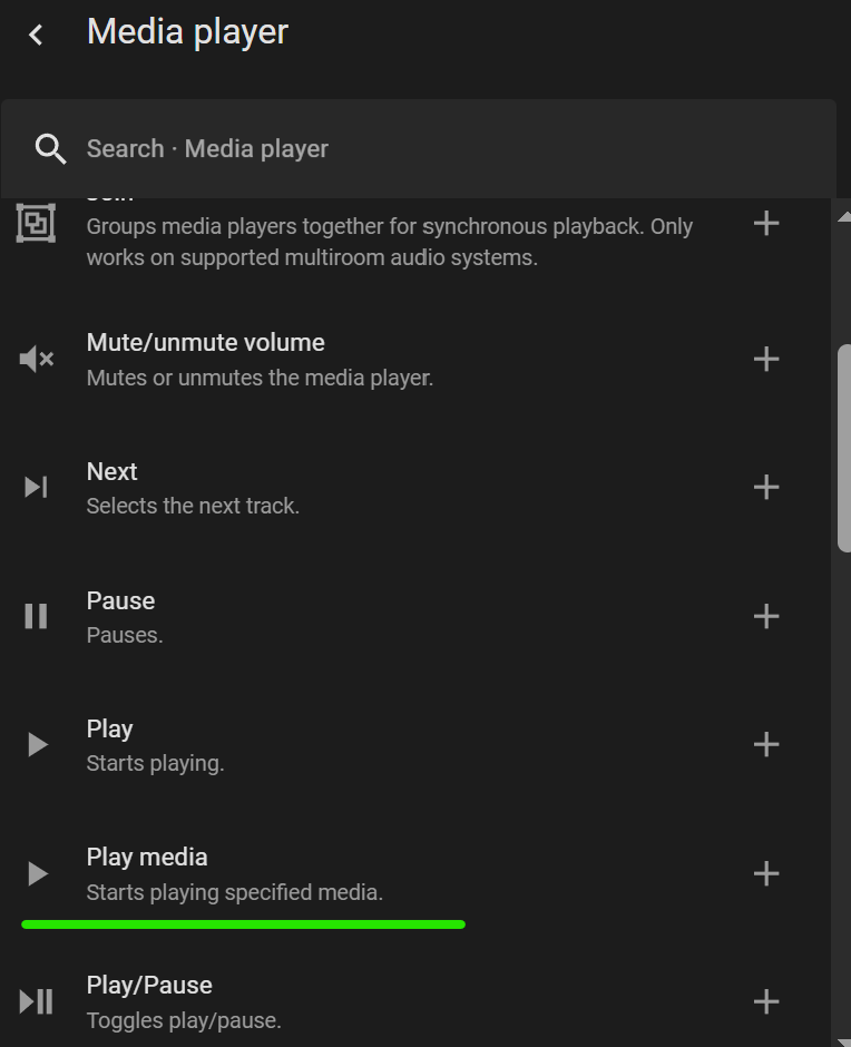

This seems to have stopped working?
HA throws an error:
The automation “XXX” (automation.xxx) has an unknown action: media_player.play_media.
This error prevents the automation from running correctly. Maybe this action is no longer available, or perhaps a typo caused it.
To fix this error, edit the automation and remove this action.
Select Submit below to confirm you have fixed this automation.
Select the second Play Media option in the Automation action, not the one at the top of the list
