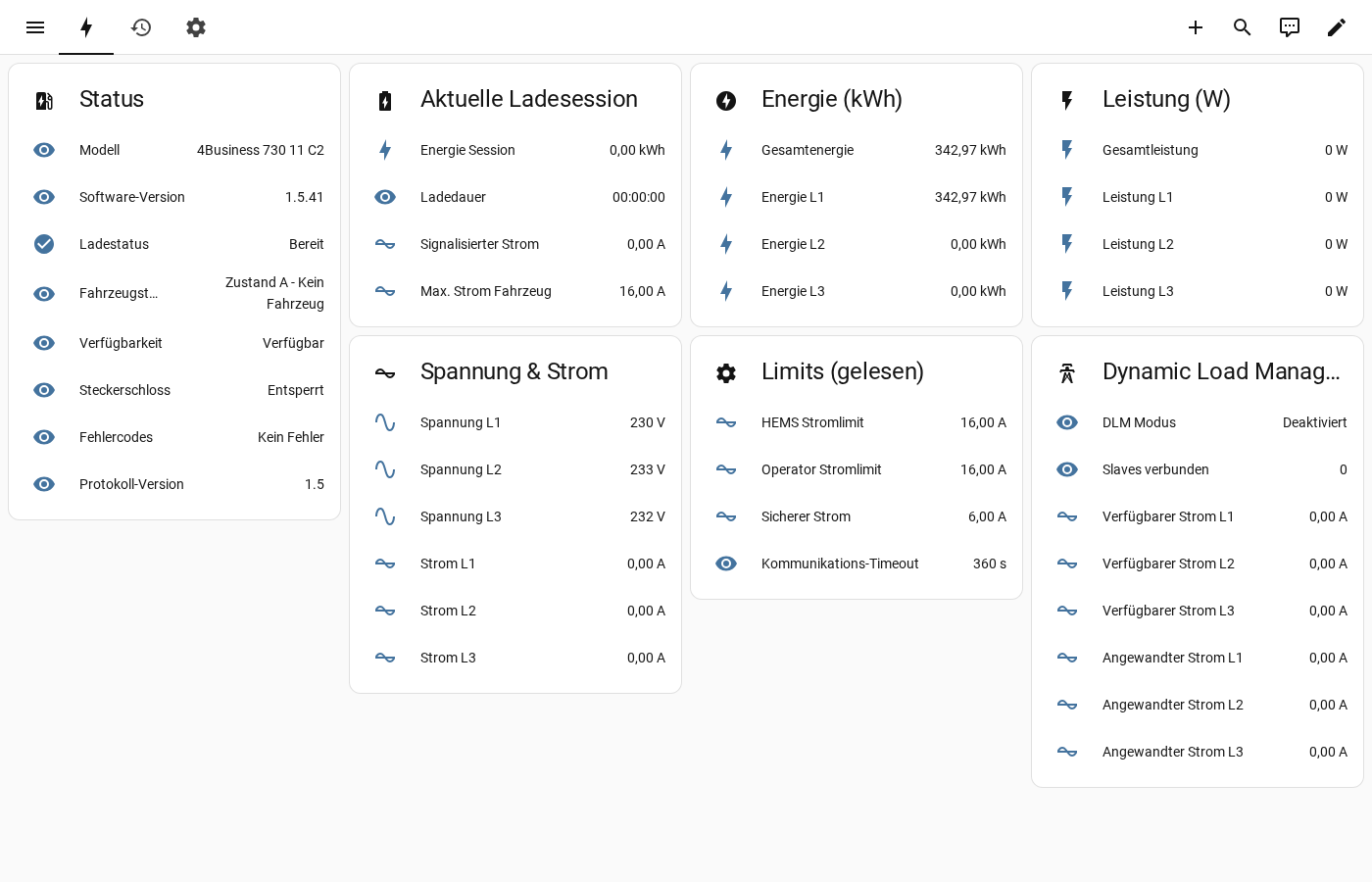

I'd like to share my Home Assistant integration for the Mennekes AMTRON 4Business 730 wallbox (11kW), which communicates via Modbus TCP — no cloud, no app, fully local.
What it does
  • Real-time monitoring: power, energy, current per phase, CP state
  • Charging session history fetched directly from the wallbox REST API
  • Vehicle tracking by RFID card — assign names to up to 4 vehicles
  • ApexCharts stacked bar chart: monthly kWh per vehicle (last 6 months)
  • Charge current control (6–32 A) directly from the dashboard
  • 3-tab Lovelace dashboard: Live Monitoring / History / Configuration
