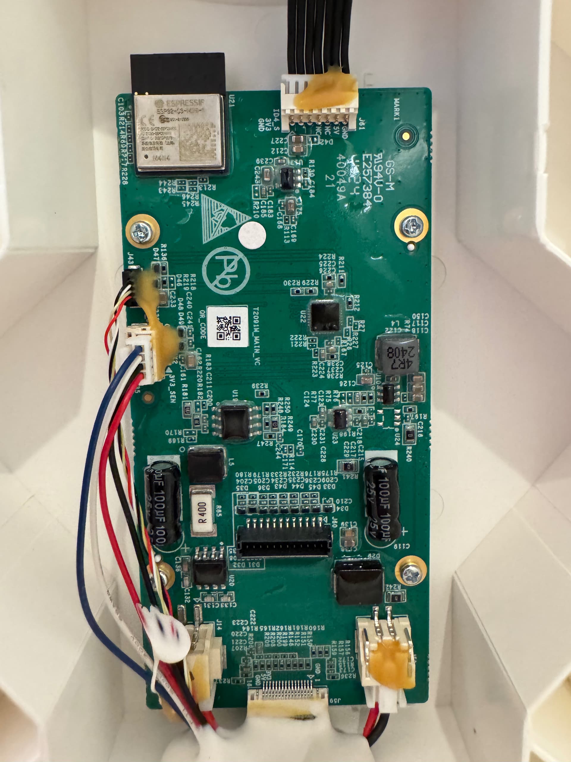

Decided to pop it open, happy to see a familiar microcontroller inside, an ESP32-C3-Mini-1. I unfortunately know next to nothing about how to create things for ESPHome (but would be willing to learn!), but I did take pictures of both the front and back of the board if that may help anybody smarter than me. Seems like there are RX/TX pads on the back of the board, but are very small. Willing to open up a GitHub to throw these in if there is interest in contributing to this.

Do you happen to have a picture of the full board with connections?

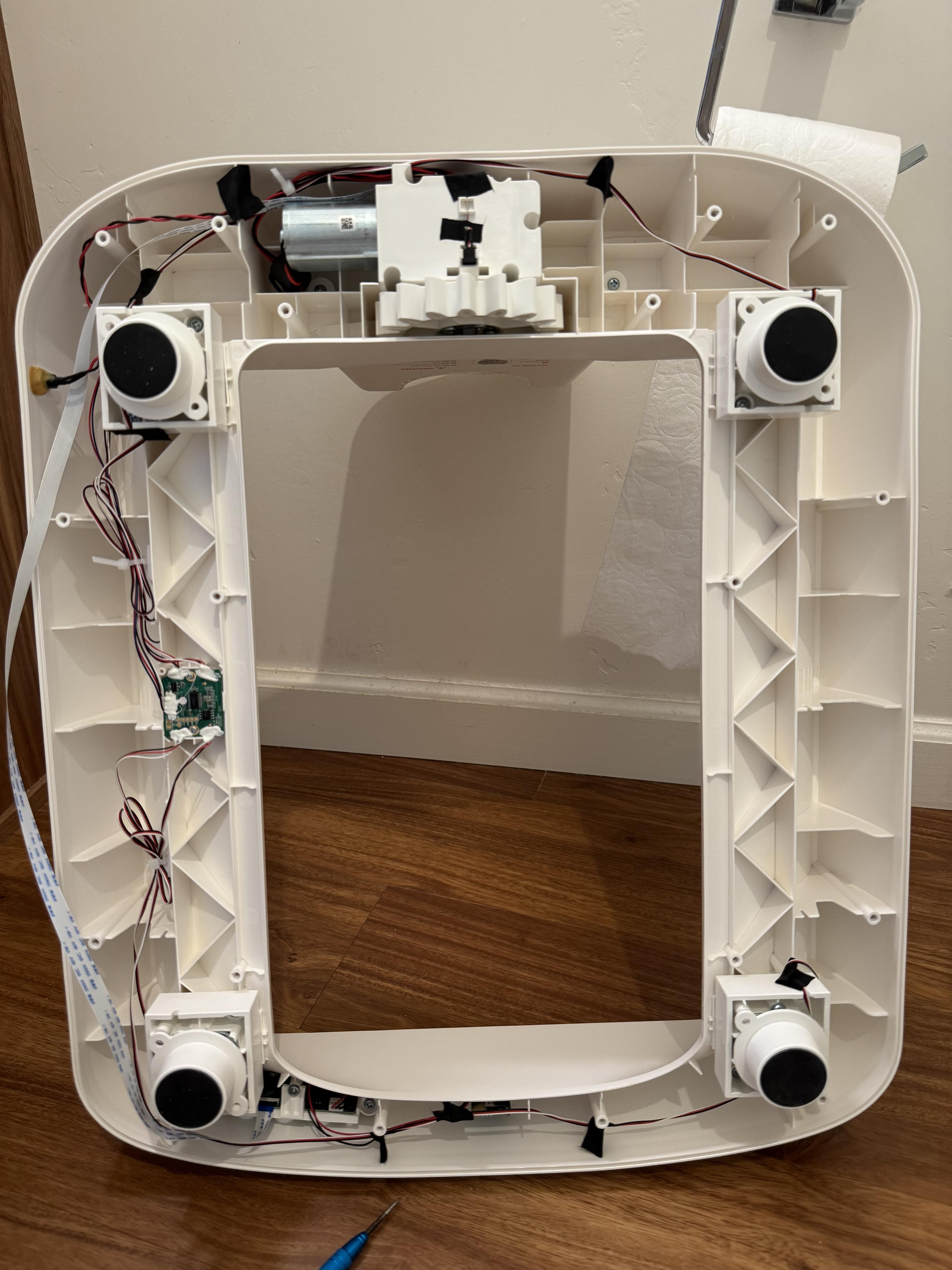

this is the SC-01, last time I did a full cleanup, I took a few quick pictures to have an idea on what was generally there
didn’t know where to post them, so I put them on imgur (I don’t know how long they will stay there), but the forum wouldn’t let me upload more than 1
has 4 Hall effect sensor to sense rotation, 3 seen on the back of the main board (which is otherwise mostly empty), magnets are on the drum (3 lozenge shaped pieces), and a 4rd Hall effect sensor on a separate small board to detect the back cover.
I vaguely remember a sensor pointing in the middle back into the drum, which isn’t transparent, but not fully opaque either, so IR might go through ??
This is smilingly a spot for a camera (similar to a pi cam), and I guess those covers are replaced with transparent plastic when that model.
has a front mounted sensor, possibly microwave at the base front, which stops rotation when cat or human walks in front of it
four load cells on the feet connected to a small board with something similar to an HX711 ADC
an IR emitter and sensor to check/count gear rotation
board with buttons and led
and of course a motor
That’s a lot more complex than I expected!
Yeah I was surprised as well!
But most if not all sensors are potentially just simple binary input, the load cell is the only one that wouldn’t be.
Motor is single speed, bidirectional, so likely connected to two relay/transistor for each direction, or sends a numerical value, which is then handled by another small chip?
Taking notes of the leveling and cleaning pattern, when the Hall effect sensors are triggered shouldn’t be too hard.
I haven’t played with load cell yet, but I assume there is a simple zeroing command, no idea if calibration is needed.
the main issue would be if the ESPhome is able to communicate with all of the sensors as is, or is the firmware more intricate.
And worse case ends up with a dud, as the stock firmware is not easily available, so that’s scary considering a replacement price, and only thing holding me back.
what could be done however that is safer, is in line with what people suggested, and add our own halleffect sensor (one should be enough for standard cleaning cycle detection, and likely figure out a way to filter the leveling cycle so that it doesn’t count), there is easy access to power there and lots of space, so a mini ESP32 board could be added in the back.
did a full clean again today, so opened the back once more
a few more notes:
a magnet close to the top hall sensor (one on separate small board where the camera would also be) is enough to make it believe the cover is installed and it believes the drum is installed (so doesn’t check the weight of the drum for drum presence)
  • top middle connector goes to that Hall effect sensor that check for rear cover presence, extra wires are for powering a non existent IR light for the non existent camera.
  • bottom right on my picture of the board is 12v input
  • bottom left plug is direct power to motor, receiving 7.8v or “-7.8v” based on rotation otherwise 0v when not moving.
  • the weight cells (the bigger of the two connector on the middle left side) could likely be used directly on a spare ESP32 (actually got an error mentioning the weight cell in the app as soon as I disconnected it)
  • I think the micro connector on the middle left is the IR in/out (?) that goes to the large gear teeth
  • the bottom middle connector is a ribbon that goes to the front buttons+led and likely the front microwave (?) sensor.
