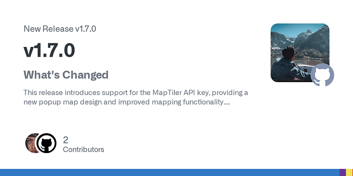

New version of card released :tada:
What’s Changed
This release introduces support for the MapTiler API key, providing a new popup map design and improved mapping functionality. Additionally, Simplified and Traditional Chinese translations have been added.
If you find this card helpful, please consider giving the repository a :star:!
New Features :tada:
Fixes :bug:
  • Corrected the spelling of “Acceleration” in ecoScore localization files. #109
Translations :earth_africa:
  • Added Simplified and Traditional Chinese translations. #103 by @knoop7
