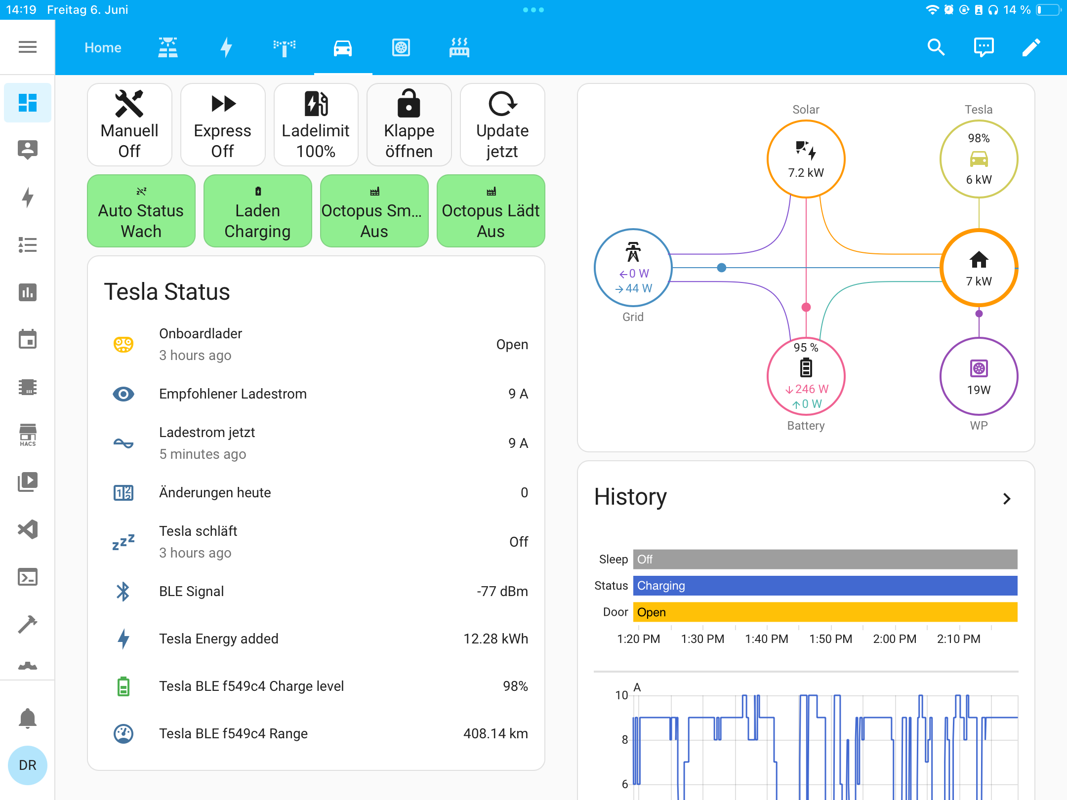

As a comparison, this is how charging my Tesla works right now with HomeAssistant and an ESP32 that acts as a BLE-gateway to the car. Since this is all a bunch of template sensors and automations, I can adapt it to any car, provided I can find some basic functions like start/stop/set current/query cable connection.

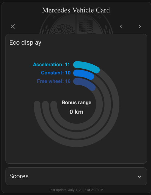

That is a great looking dashboard. Similar to what I had with the juicebox before they shut down the API and removed everything. Is this something you have a tutorial for?
And the mb app works great for me, I just wish I knew how to get the eco rings as a standalone card!

Thank you, this is very helpful! What I’m doing on my car (and some Tesla owners in Germany who use my solution) is:
I have a template sensor that uses roof generation, house battery SOC, car SOC and grid meter to calculate a sensible charging current.
Then, I have an automation that runs once per minute or every time the template sensor changes its value. Based on optimum amperage and charing state it has three actions for start, stop and current-setting.

Maybe @VietNgoc has an idea on how to solve it. He/she is the frontend master :slight_smile: and can explain how you could get this here as standalone.

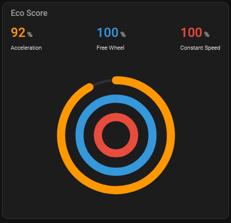

Compared to @VietNgoc , I’m only a hack, but here is mine:
Done with apexcharts.
type: custom:apexcharts-card
chart_type: radialBar
header:
  show: true
  title: Eco Score
  show_states: true
  colorize_states: true
series:
  - entity: sensor.XXX_eco_score_acceleration
    show:
      legend_value: false
  - entity: sensor.XXX_eco_score_free_wheel
    show:
      legend_value: false
  - entity: sensor.XXX_eco_score_constant
    show:
      legend_value: false
apex_config:
  plotOptions:
    radialBar:
      hollow:
      dataLabels:
        name:
          show: false
        value:
          show: false
      track:
        strokeWidth: 30%
        margin: 20
  legend:
    show: false
