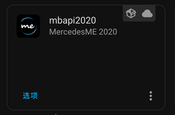

Hi Rene,
still no device or entities at all
I installed the integration you gave me ,selected Europe
1.install the integration
2.fill my mb-email address
3.fill pincode received by email
4.restart HA
Should I add any code into my configuration?

did you try to set a correct country? I cannot remember in detail what I did when installing, but in fact I changed also the country code and the locale.
so for me its (configuration button for the integration)
Country Code: DE
Locale: de-DE
As far as I remember I also needed to change that. Furthermore have you enabled ānew added entitiesā with the option menu? (three dots)
And make sure you connected your phone app with the car before. Not sure about your model and year of the car. But in my E Class I can see the Me symbol for my user on the screen. You can also check on the website of Mercedes if your account is linked to Mercedes Me.
EDIT: did you clean your browser chache as well?
