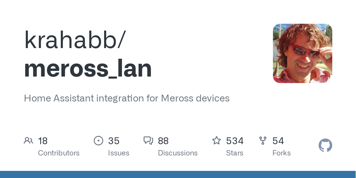

I’m using the Meross LAN integration.
EDIT: Adding the link to Meross LAN.

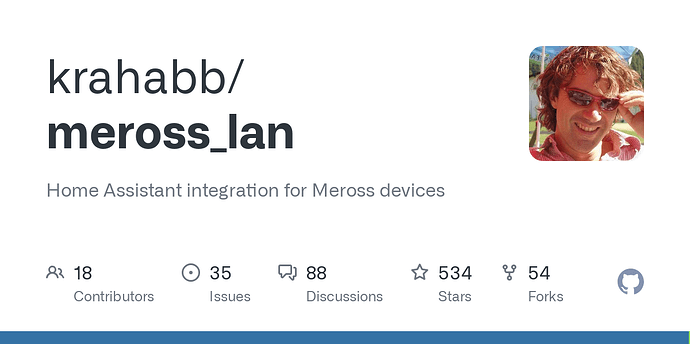

It worked with Meross LAN, but since a week or so both MS600 sensors stopped working: MS600 Presence sensor does not report presence anymore. · Issue #599 · krahabb/meross_lan · GitHub
I have now integrated them into Home Assistant via Matter. They work, although only the occupancy and light sensors are exposed, but at least they work reliably.
