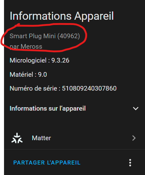

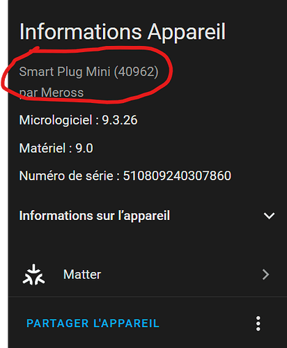

The image show the new one :

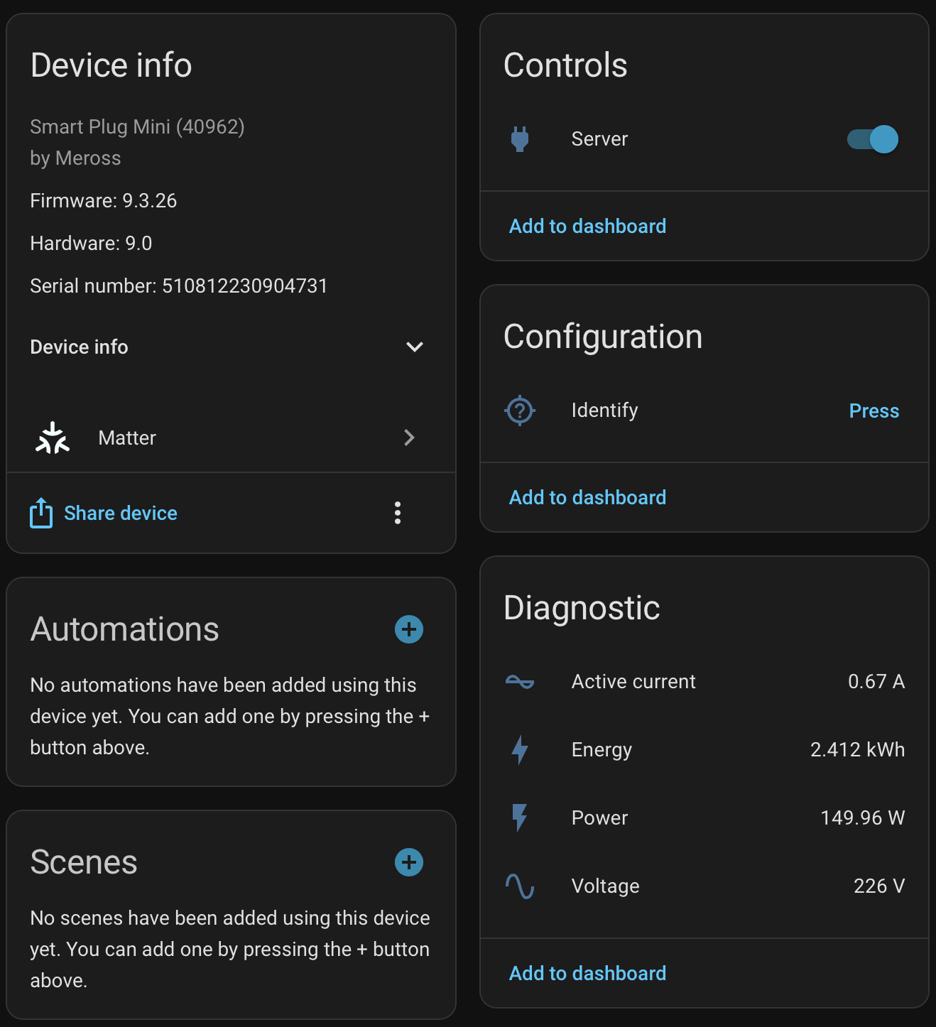

Mine only show power in a special diagnostic area, and not on the automatic dashboard. Are yours different?
