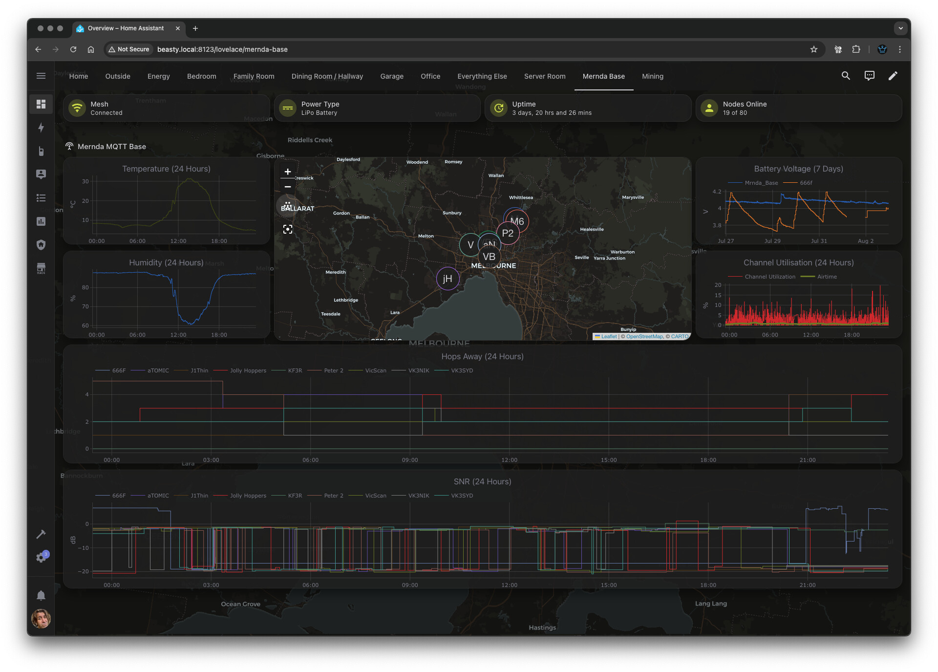

OK worked it out. This is what I have running at the moment as well as HomeAssistant running a very simple Infobot.

This looks great, any tips on how you got it working? I have some devices turning up soon and would like to do something similar.
Mine is no where like that. Myself I am trying to do all voice or text notifications. Unless I am fixing something I never look at the dashboard. That is Awesome! are you running any automations with meshtastic? One that I was is this. I have 2 - T1000E and a node connected to Home assistant and a solar node. When the internet drops out. I use it for my notification at home. Or when I am less than a mile away from home. I am not on the public channel.
Is there any chance you could share your card setup? That’s an awesome looking page.
@KmanOz Great looking page! Are all the nodes on the map yours? Or is that all nodes heard/seen by your node?
If so… how’d you get them on the map? Allow all nodes to create device trackers?
