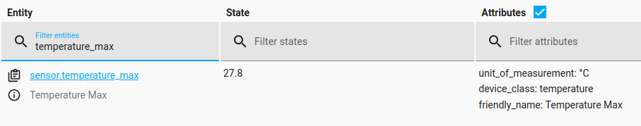

I just tested it on my system and it reported the maximum forecasted temperature for my area.

I thought you had asked for the maximum forecasted temperature. Your modified version, of my example’s template, does not do that.
EDIT:
I see you changed the value of type from hourly to daily.
Very odd indeed because the example I offered does work.
BTW, the reason my template excludes strings (using reject('string')) is because there are rare occasions when met.no doesn’t report a numeric value for temperature.
