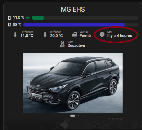

Hello, I managed to use this card, but I’m having a problem.
I don’t know how to force the retrieval of the car’s data. Sometimes it takes several hours without any feedback.
