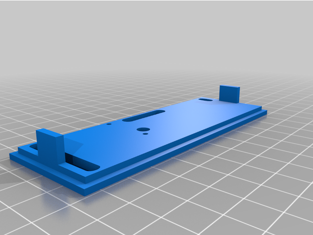

It does not have a box but if you have a 3D printer or know someone I made one the file is here.
