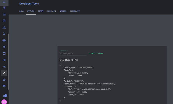

goto events and put deconz_event in the listening to
I drop on the desk with the Aqara logo on the top
mark that face as 1 then turn it one face over
note the event 5001
now turn it back
note the event 1005
base on that maths
1005 mean cude has side 1 on top and came from side 5

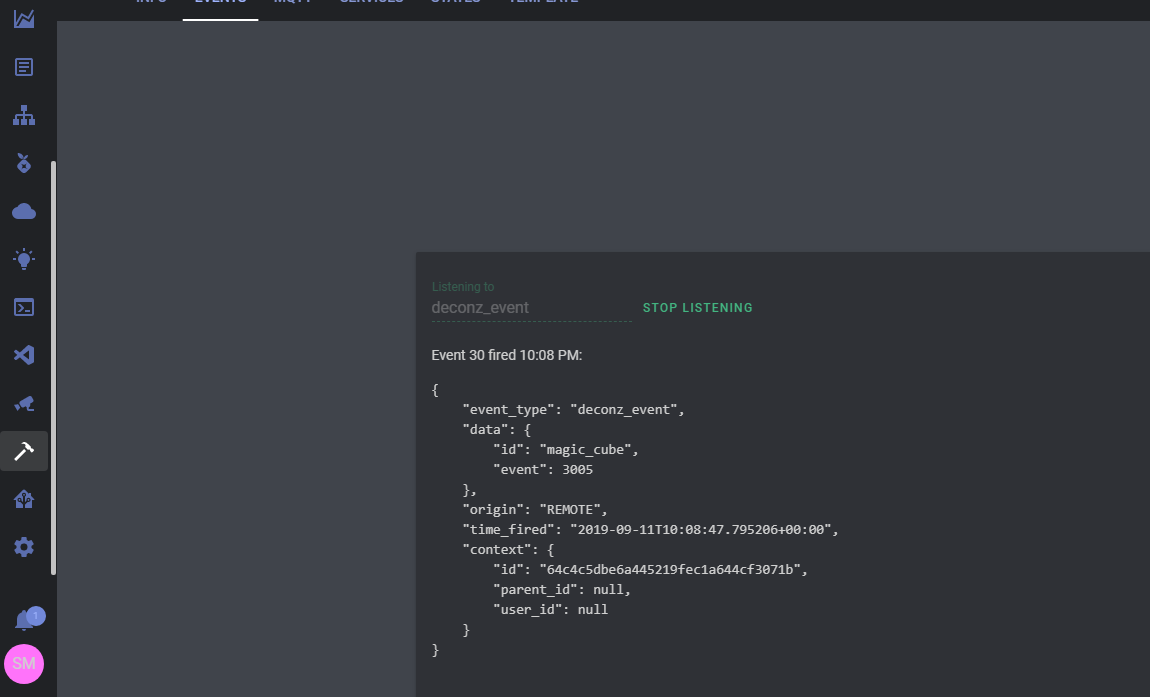

if double tap side 1
i get event 1001
now i turn to side 5
event says 5001
do double tap
event say 5005
