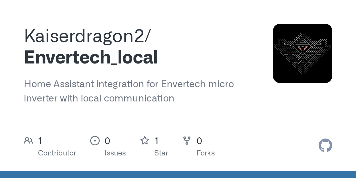

I also created an Home Assistant integration for Envertech micro grid inverter.
this one communicates through the local tcp server and does not interact with the cloud.
