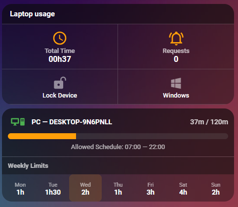

I’m sharing a custom integration I’ve been working on to bring Microsoft Family Safety into Home Assistant. If you use Family Safety to manage your kids’ screen time on Windows, Xbox or Mobile, this lets you monitor and control everything from your HA dashboard.
What it does
  • Monitor screen time - total usage per child, per device, per day
  • Adjust daily limits - change the allowed screen time for each day of the week directly from the UI
  • Set allowed time windows - control when the computer can be used (e.g. 07:00–20:30)
  • Lock/unlock accounts - one switch to instantly block all screen time (saves current settings, restores them on unlock)
  • App management - block/unblock apps, set per-app time limits
  • Web filtering - block/allow websites, toggle content filtering, set age ratings
  • Approve/deny requests - handle screen time extension requests from HA

Hi, sorry to be a pain but…
The rest of the integration works great, I may be expecting more that it was designed for, to explain
For example:
Child 1 has 15min allowance on Windows & 60min on Xbox for Monday = 75min total screen time.
Should there be a single number.kxx_cxx_family_safety_kxx_monday_limit that shows the total of the two (75) or should there be two number.xxxxx sensors, one for Windows and one for Xbox?
I am only seeing the windows duration and times, not Xbox.
The two sensors for the totals of Windows & Xbox work as expected, the list of apps and games is listed complete, the two sensors for the totals of Windows & Xbox work.
Like I say, the rest works great and being able to change the time sensor would be very useful.
