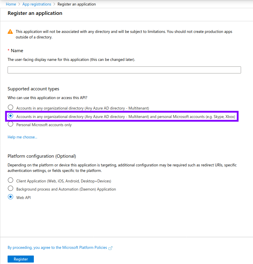

When trying to authorize I get a 500 internal error on the front end and the following in the logs:
oauthlib.oauth2.rfc6749.errors.InvalidClientIdError: (invalid_request) AADSTS50194: Application '102c152a-4569-421f-9096-7045b3d150ef'(HomeAssistant) is not configured as a multi-tenant application. Usage of the /common endpoint is not supported for such applications created after '10/15/2018'. Use a tenant-specific endpoint or configure the application to be multi-tenant.
I do have 2 MS accounts, one work one personal. I setup the Azure account using the personal account and I’m use the same one when trying to authorize.
Any suggestions?
Thanks in advance.
I managed to get past this error by editing the Manifest file within the App I created in Azure to allow for multi-tenent environment’s:
"signInAudience": "AzureADandPersonalMicrosoftAccount"
Hi Eoin, I have the same issue. Could you explain what you did exactly? I cannot get it to work…
Log into the Azure Portal: https://portal.azure.com/#home
Navigate to: App Registrations
Select the App you created when following: https://github.com/black-roland/homeassistant-microsoft-todo
Click on: Manifest (left hand menu)
Find the section for: ā€œsignInAudienceā€
Change the current value to: AzureADandPersonalMicrosoftAccount
Click Save. That should be you.
Oh, it seems the registration UI changed and instructions are out of date.
As an alternative to the manifest editing you can try to select ā€œAccounts in any organizational directory (Any Azure AD directory - Multitenant) and personal Microsoft accounts (e.g. Skype, Xbox)ā€ while registering a new app in Azure:
Thanks, got it working!
