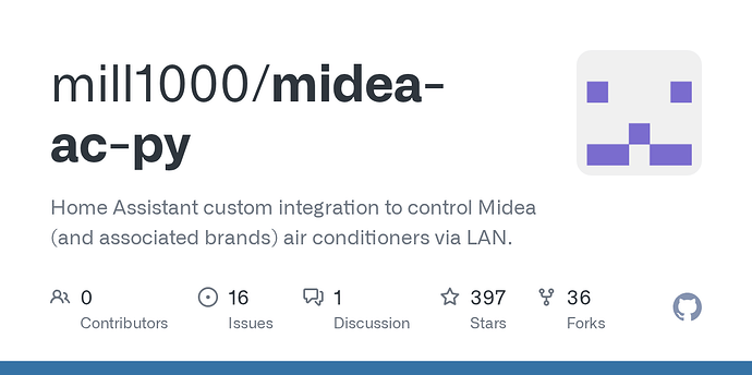

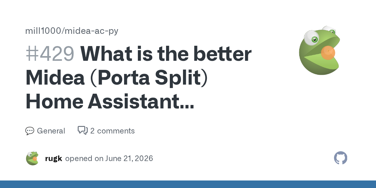

There also seems to be this fork, which is only about AC devices, not all Midea devices?
Anyone any experience which one is better? They both seem to be maintained (have recent commits)
I can only say I use that one and that the maintainer is very responsive. I've had no issues.
Yeah, also asked the maintainers for what they think (especially, because I also found yet a third):
Midea Smart AC also seems to be my favorite. I tried all, one did not even work and the other worked but is intended for much more devices.
That said apparently they want to add Midea support to the HA core.
