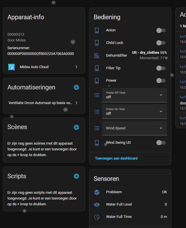

You can give a try to this workaround, it worked for me:
I ran into the exact same issue, but I managed to get it working perfectly today using the **Midea Auto Cloud integration via HACS.
this are the steps i made:
Open HACS, search for Midea Auto Cloud and install it.
Restart Home Assistant. Once it’s back up, go to Settings > Devices & Services, click Add Integration, and search for the Midea integration you just installed.
When prompted, ensure you check the box for MSmartHome and log in with your credentials.
Hold the Wi-Fi button on your dehumidifier for about 5 seconds until it enters pairing mode.
Open (or install) the MSmartHome app on your phone.
Home Assistant should now automatically detect your device and bring it into your dashboard.
and this is how it looks like:
i hope this helps.
