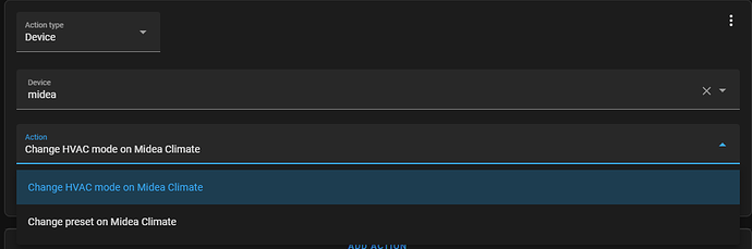

Am I missing something or can the target temperature not be changed by automation in HA?
I have my unit set up as an ESPhome appliance and I am able to change the temperature though a climate card no problem.
However, I cannot find the right automation settings to change the temperature.
When in the action part of the automation, I pick action type Device and then midea and only get HVAC Mode or Preset.
If I change to action type Condition, I select Entity Midea Climate and then attribute temperature, then set the state to the target temperature. When I run the action, the target temperature doesn’t change.
I can go into the developer settings and change the temperature state that way and it work.
I thought this would be easier lol
